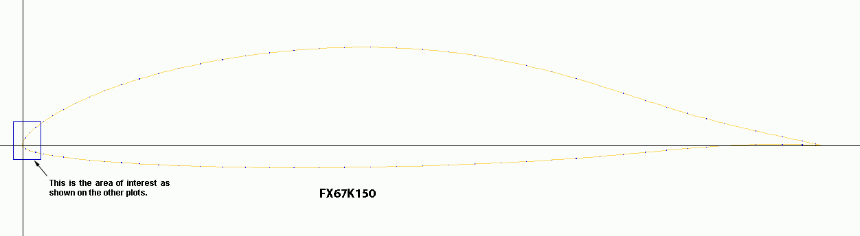

I was trying to use Autocad to plot the airfoil shape for eventually
creating leading edge templates. In doing so I came up with a couple of
questions.
I started with the coordinates from the UIUC database.
http://www.aae.uiuc.edu/m-selig/ads/coord/fx67k150.dat
What I wanted to come out with was something like this:
http://www.goddard.com/soaring/info/FX67K150.gif

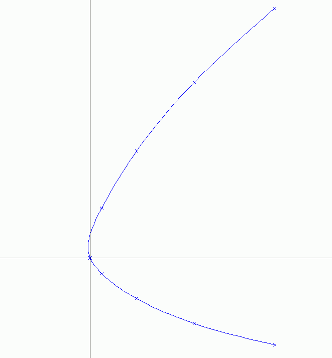

around the leading edge and along the other surface.\
But that approach came out with a leading edge like this:
http://www.goddard.com/soaring/info/spline-full.gif
This gave a very nice faired curve but it extends too far forward (into
negative X territory) and puts the actual leading edge above the
centerline.

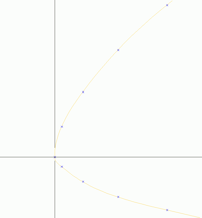

So then I plotted it with the top surface and bottom surface splines
separately forcing each of them to a tangent with a vertical line at
(0,0). That produced the following:
http://www.goddard.com/soaring/info/spline-normal.gif

None of this will solve the problem. The real problem
is that like with most early Wortmann sections, the original
FX67K150 coordinates are grossly too coarse at the leading edge.
A cubic spline will produce bad glitches just above and just
below the 0,0 leading edge point. There are many different
types of cubic spline parameterizations possible, but they
all produce shape glitches with various degree of severity.
What I usually do in such situations is to add points
near the LE point, and then smooth the local LE shape
by smoothing the local Cp(s) distribution in Xfoil at high
and low angles of attack, like +15 and -10 degrees.
Whether or not this produces the "correct" shape is a moot point,
because the correct shape cannot be determined from the
official coordinates. At least it produces a shape with
a well-behaved Cp spike, which is really what matters.
Old January 20th 04, 02:28 AM
Mark Drela
If you have a CAD program that will allow you to impose tangency
constraints as well as point location (like CATIA or UniGraphics), you
can force the curve to be vertical at the leading edge.
In Xfoil you can effectively do this by placing a point just above
the 0,0 LE point, and placing another point just below. For example,
change the three points at the LE...
0.001070 0.004620
0.000000 0.000000
0.001070 -0.001450
to...
0.001070 0.004620
0.0 0.00001
0.000000 0.000000
0.0 -0.00001
0.001070 -0.001450
Xfoil's arc-length spline parameterization doesn't care
about the resulting very non-uniform point spacing,
so these new coordinates spline OK without any difficulty.
But in the case of the original FX67-150 coordinates,
this still produces overshoots, with a concavity below
the LE point (top looks better, but still wavy).
The real problem is that the necessary geometric
information is simply not present in the coarse
coordinates. An adequately-smooth interpolated shape
has to be literally "made up" in one way or another.
questions.
My attempts were to use the "spline" command in order to fair the shape
through all of the points. The problem came with the leading edge area
(doesn't it always!). My first attempt was to simply use the spline
command for the top surface and then the bottom surface. But this left
me with a hard point at the leading edge (0,0). Clearly, one needs to
create some sort of 'fairing' around the leading edge. Intuition told
me that I should start the spline at the trailing edge and continue it
centerline.
Now that looks about like what I thought it would... but the questions
occurred to me... What is the "official" method of creating accurate
plots from the data? How was the coordinate system designed in order to
be able to accurately recreate the shapes? How did they calculate this
stuff before the advent of computers and CAD programs? I know they had
an arsenal of 'french curves' but there seems like there would be a lot
of "eyeball judgement" in that approach.
Just wondering...
Larry Goddard
"01" USA
