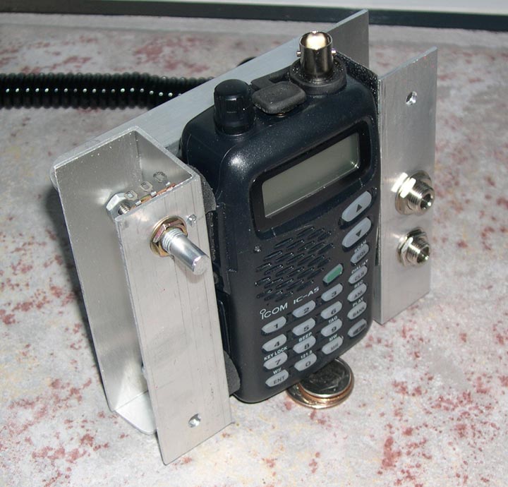

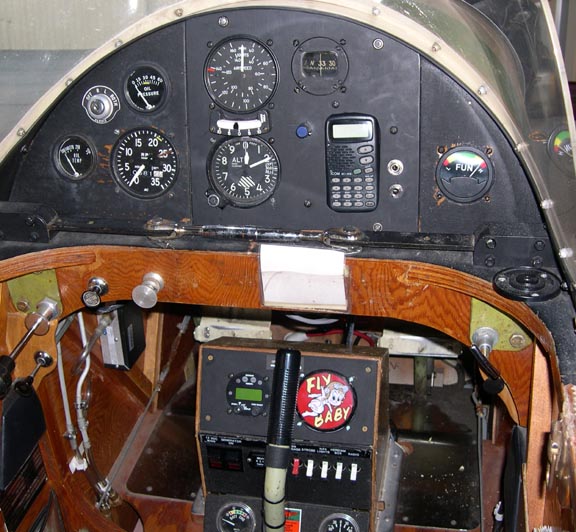

Well...it's not exactly an "either/or" situation. Check out the panel mounting
of an ICOM IC-A5 in my Fly Baby:
http://www.wanttaja.com/hhrad2.JPG
The radio is wired to conventional panel jacks, and is powered by the aircraft
12V bus by a "Battery Eliminator" purchased from Batteries America. No
modifications to the radio were needed...I just built a cage from 1.25" aluminum
channel (actually square tubing with one side cut away) and purchased the
four-conductor plug that fits into the headset adaptor jack for about $7.
The radio assembly is essentially self-contained...the headset jacks mounted
onto the side rails of the aluminum channel. The only wiring on the airplane
was a 4-conductor plug for power and PTT switch (plus the antenna, of course).
http://www.wanttaja.com/hhrad.JPG
The potentiometer is used to adjust the volume without being able to access the
knob on top. Everyone seems to understand me (quite unlike RAH :-), I can
receive stations 75 miles away, and whole installation weighs less than a pound
and cost less than $300.
I made a couple of postings about it to the Fly Baby mailing list:
http://groups.yahoo.com/group/flybabylist/message/5006

I'll second Ron's use of a portable. I've been doing the same in my
homebuilt Savannah, also with an external antenna. It works fine. Mine is
an Icom A23. The VOR function is pretty lame, so I would save my money and
get a com only radio next time. The range seems to be as good as the "real"
radios in rental planes.
Don't forget that you'll need a transponder to go into a class C airport.
tom

Yeah whatever regarding the radio... I like the gauge on the right hand side
of your panel Ron. Nice to see that even sitting in the hangar it's pegged
at the redline ;-)

Ron, that is so cool, I want a fun gauge! Any suggestions as to where I
might find one?
Gary Melton
N320GG LNC2
"Jase Vanover" wrote in message
side of your panel Ron. Nice to see that even sitting in the hangar it's
pegged at the redline ;-)
might find one?
Your junk box, if you're lucky. The Fun Meter started out as a small voltmeter
made out of plastic. Once disassembled, the meter face was found to be a small
plastic disk held in place with a couple of tiny screws. I noted the size, drew
up my own meter, printed it on photo paper, and glued it over the old face.
Reassemble the meter, and the rest is history:
http://www.bowersflybaby.com/stories/meter.JPG
Originally, I kept the original needle movement but the needle eventually broke
when I had to take the meter apart to replace the paper face. I now use just a
scrap of white-insulated wire.
I've got a large empty instrument hole where the old radio used to go, and I'm
considering some kind of similar goofy project. Currently, I've just got a Fly
Baby logo in the hole...
http://www.wanttaja.com/hhrad2.JPG (Towards the bottom)
.... but I'd like to put in either a dummy radar or possibly a "weapons status"
display.
