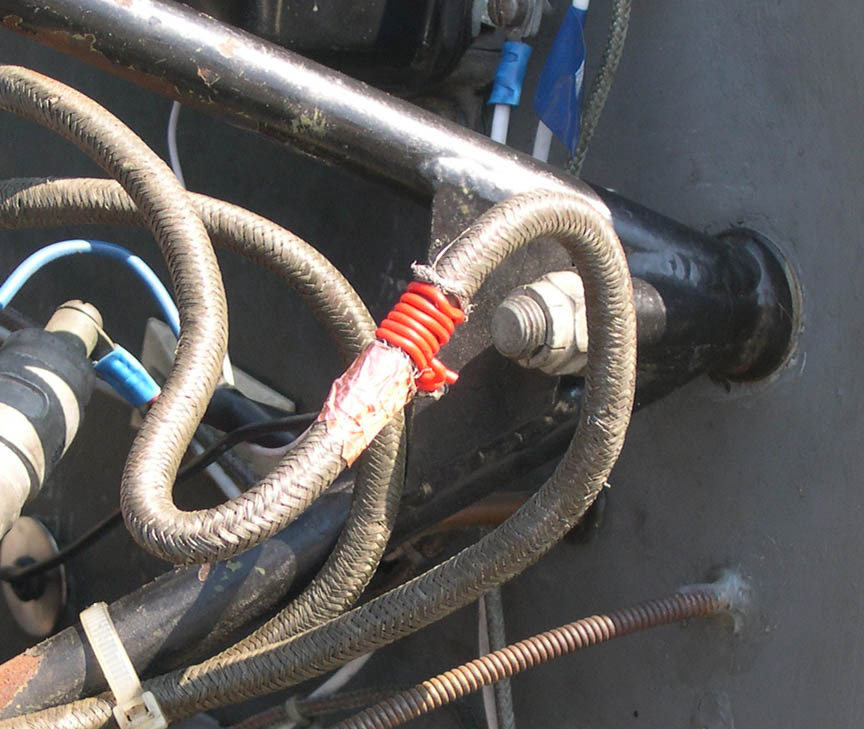

The tach worked now, but was very erratic at low RPM. I wrapped the end
of the sensor wire around the plug wire one more time, and the problem
got better. So I wrapped the rest of the red wire around the plug
(about six turns). The idle was now stable, except it would glitch
momentarily every five or ten seconds.
http://www.bowersflybaby.com/tech/tach_coil.jpg
I'd brought a headset with, and noticed that the open section in the
braid produced only a very minor bit of popping into the radio. But I'd
started to wonder if maybe my copper tape wrapping HADN'T been the

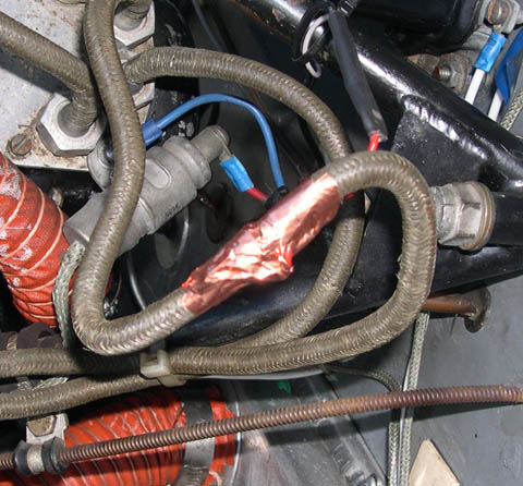

problem, earlier. I had laid the rest of the sensor wire horizontally
along the plug wire under the copper tape. The diagram from the tach
manufacturer shows the sensor wire coming straight away from the plug
wire, instead. So I re-wrapped the section with copper tape, taking
care to let the sensor go directly away from the plug wire instead of
wrapping it in the copper tape.
And lo and behold, it worked.

A test flight produced very nice operation. There's still a bit of
instability at low power settings, but once the RPM crosses 1000, the
tach is rock-steady. The copper tape shielding is working great; no
ignition noise is audible.
