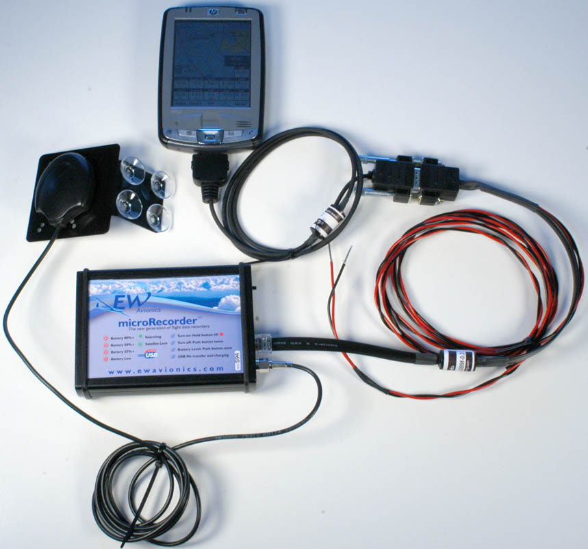

Ever since re-doing the wiring in my DG-300 last year, I get
intermittent loud static on my radio. It seems to be connected to
whether or not I have ship's power going to my EW MicroRecorder. The
odd thing is that I followed the Becker wiring instructions and made
sure to use a shielded wire for the connection from the Becker to the
remote speaker/PCB assembly. I would love ideas on how to help stop
this! Details below - any thoughts, see anything obvious that I'm
failing to do?

EW Avionics MicroRecorder
iPAQ 4700 (powered through the MicroRecorder via Goddard DB9f & I38C-1
connectors with ferrite rings at each end)

Based on the information you have given the cure may be to put an RF
filter in the EW power supply wiring as close to the EW as possible.
Start with a ferrite ring.
It is also possible you will reduce the problem my moving the EW power
lead as far as possible from any other wiring.
Andy

One note: There is a ferrite toroid on the Goddard EW DB9f connector
within about 3 inches of the EW MicroRecorder, and close to the PDA
hookup as well. My PDA and antenna are slightly different; but I use
basically this exact setup:
http://www.cumulus-soaring.com/godda...c-DB9f-0-3.jpg
(Note that the actual red-black power leads connect up at the DB-9
connector and have no ferrite toroids close-by. Not sure if that

Have you tried combinations of the PDA powered off while the EW is on
to see if it is the PDA or EW that is causing interference?
I would do the easiest change possible first. Run each of the red and
black wired though a ferrite toroid (one large enough to wrap the wire
through a few times. Try it as far up the wire as you can. Keep those
red/black wires as short as possible.
Change one thing at once. Start by trying to fix interference at its
source not the receiver unless you have to.
