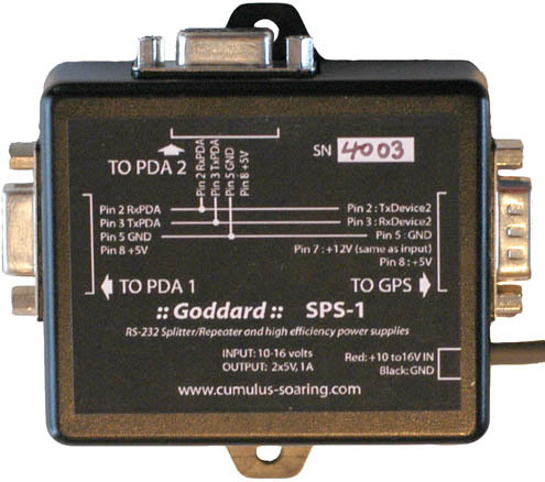

Brad,
Like Paul mentioned, sharing a GPS engine between two device is a common "Poor Man's" navigation solution. For several years I have been driving both an EW Model D flight recorder and Compaq Aero 1550 with a Garmin 12xl.
Any FAI acceptable GPS unit can be substituted for the Garmin 12xl. The Goddard SPS-1 is a good power and device connection solution.
http://www.cumulus-soaring.com/goddard/sps-1.jpg
