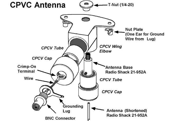

So I built the what I called the "CW McCall's Revenge" antenna from Radio Shack
and Home Depot parts, and things were OK for another year.
http://www.bowersflybaby.com/stories/antenna.htm

I was going to hook up the radio to the "CW McCall's Revenge" antenna. I put a
right-angle BNC fitting atop the radio, and ran a new coax down to the end of
the cable from the antenna, tying them together with a BNC connector.
But...heck, I guess I should check out the antenna, first.
I touched an ohmmeter to the ground plane and then to the metal shell of the BNC
connector. Infinite resistance.
Oh, HO!
The ground plane (aluminum foil on the baggage shelf) connects from the
antenna's BNC connector to one of the anchor lugs on the antenna mount....see:
http://www.bowersflybaby.com/stories/ant2.gif
The shell at the antenna connector was grounded, so it was loosing connection
between the connector and the ground plane itself. I tightened the mounting
bolts for the antenna...and the ground plane showed good.
I thought for a moment. Maybe that was all that had been wrong to begin with.
I crawled back in the airplane and reconnected the antenna to the built-in
radio. I buttoned-up the belly plate and started to put the turtledeck back in
place.
Hmmmm...maybe one last check of the ground. The braided ground line for the
receive antenna runs close to the foil ground plane. I touched the ohmmeter
between the two.
Nothing. Damn, they *have* to ground to each other...each attaches to the case
of the radio. I decided to ground the foil to the braid with a separate wire.
I got one side installed, but then had a fit of conscience. Damn it, I wanted
to *solve* the problem, not kluge a way around it. Besides, having two separate
grounding paths to the foil is a classic setup for ground loops (the electrical
kind), even worse when one was apparently intermittent.
Time to pull the antenna. I'd designed it to be easily removed from outside the
aircraft, with both mounting lugs including nut plates. The ground plane
connected via those anchor plates. Since the plates weren't really intended for
electrical functions, I suspected that perhaps some corrosion in the plate or
the cad plating flaking off the bolt was disrupting the electrical path. The
best solution would be to replace one of the nut plates with a conventional bolt
and a grounding lug.
The antenna came off quick enough, and the anchor nut came off easily. As it
did, the ground wire to it popped free. Looks like I hadn't soldered it
properly...I seem to recall having problems getting the nut plate hot enough.
