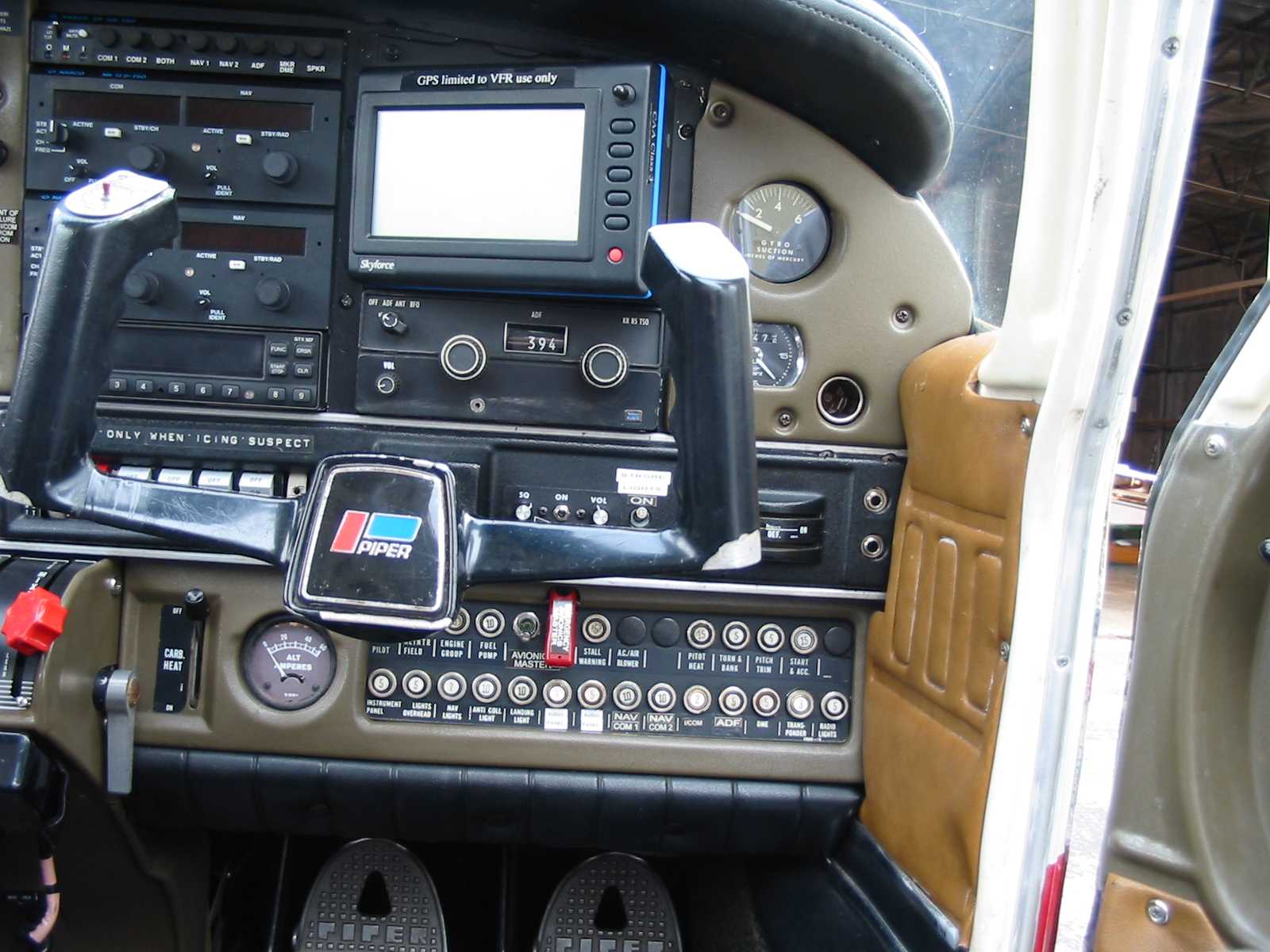

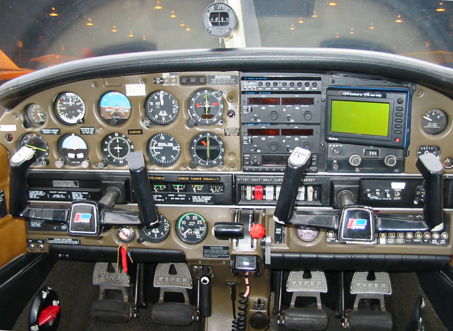

We tried a Gimbal Mount on the passenger side for use with a
SkyforceII which tended to stick out of the panel too far and was not
satisfactory. Reflections on the screen were the problem.
In the end we fitted it on a fixed angled mount, slightly recessed on
the left side, which was all signed off when the new avionics were
fitted.
Have a look at the following pictures, which may help:
http://www.lochaberphysio.free-onlin...panel_full.jpg
http://www.lochaberphysio.free-onlin...anel_right.jpg
David

Old July 7th 04, 12:38 AM
On Tue, 6 Jul 2004 13:45:28 -0700, "NW_PILOT" wrote:
That would be nice to do but this is a Cessna 150 and my panel is full, I
was thinking above the compass see hand held photo
http://www.warflying.net/sm3.jpg I could faberacate a mount that could use
one of the holes for the compass
I appreciate the problem but the Skyforce so near to the compass would
no doubt require a compas swing. Additionally the wiring is likely to
induce changes in the magnetic field as the GPS draws more or less
current. I suspect the compass variations would not be acceptable!
We had to use a VOR/ILS indicator with DME built in as the panel space
would not accommodate the DME when we fitted dual NAV/COM.
Good luck.
David
E-mail (Remove Space after pilot): pilot
